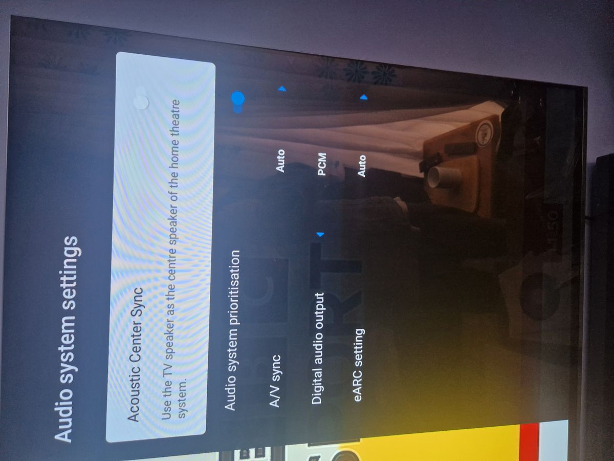

Here are the current settings. I get the same symptom if 'using the TV speakers as the centre speaker of the home theatre system' is enabled.
Why the digital audio output is set to pcm? It requires the TV to downgrade to stereo analogue audio instead of the original digital signal. It could be that this is not the root cause but for sure you are getting a worst sound from your soundbar....
….and a delay each time while the soundbar tries to sort out the ruins of your audio!
Thanks for your reply. PCM was the default setting, so I left it alone whilst changing other variables.
In response to your comment I have changed the setting to pass through for digital audio. I will keep it at that for 24 hours to monitor a variety of TV programme types for delayed sound. Given that I have already switched on the dealy adjustment feature with no improvement, I hope that your suggestion removes the need for my sound system to cope with the 'ruins. caused by my choice of settings.
