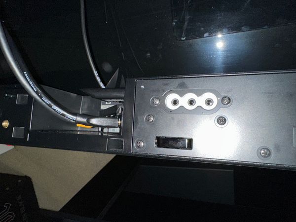

I've just come across your thread, and would be interested to know exactly where the port is on the sound bar unit (I tried one sticker and it seemed like a service port). Would you be able to post a photo? Prefer not to start digging around for anything that seems like a sticker!

Hi, I just found out about this and was able to remove the stickers as well, and I got you with the picture, but I’d also like to point out that a bluetooth transmitter workaround is a terrible idea since those bluetooth rear speakers will 100% lag behind compared to the rest of the system. It’s just the way Bluetooth is. You’re better off purchasing the official ones.
