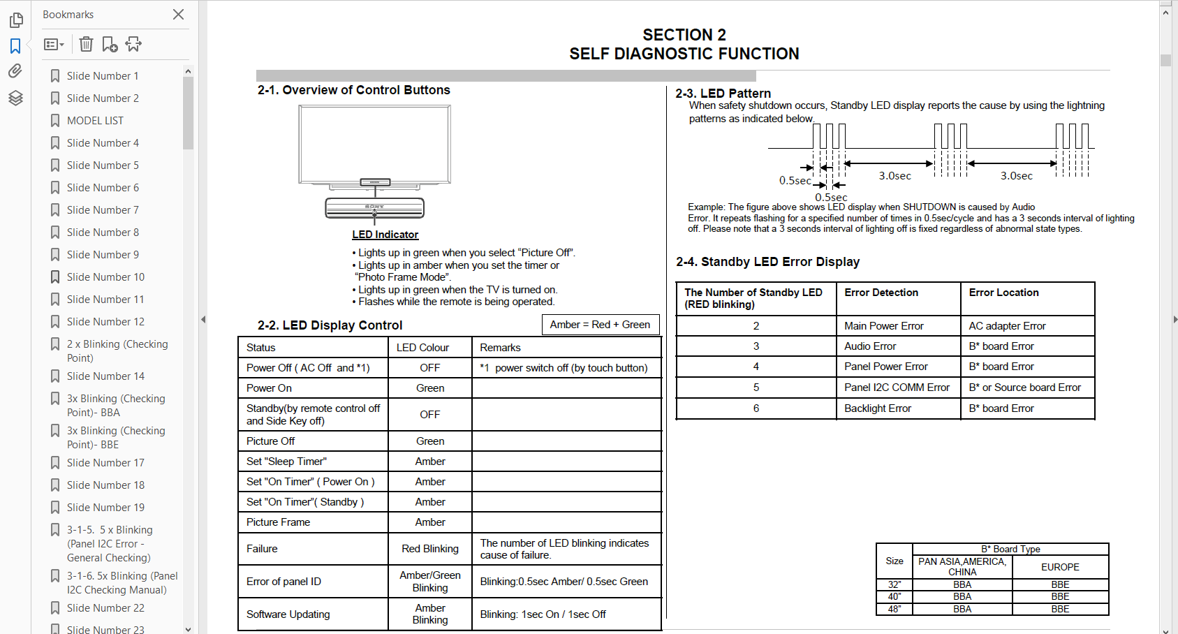

a friend found a service manual for Sony tvs: Amber/Green Blinking = Error of panel ID

Send it to SONY, looks like they don't have this manual.  :slight_smile:

Even though the screenshot above says amber/green = error of panel ID.  It could also be a case of a combination of these lights.  For example it says Amber = Red+Green.
So, you could have:
  • Power On = (Solid) Green  + Blinking red for Failure - hence Amber+Green; or
  • Picture Off = (Solid) Green + Blinking red for Failure - hence Amber+Green;
etc.
