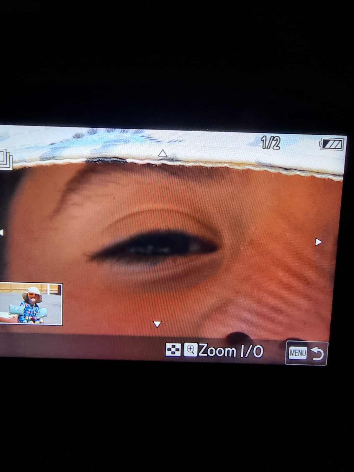

I have used my A7IV and 135mm 1.8 GM couple of days now and have been shooting outdoors mainly running dogs but also stationary subjects. It seems that bird EYE AF works pretty flawlessly. With dogs and humans eye AF tends to front focus a lot. Focus frame display on camera and on computer shows that it should be on the eye but focused area is on the eye lashes or to somewhere else instead of the eye IRIS like it was on A7III.

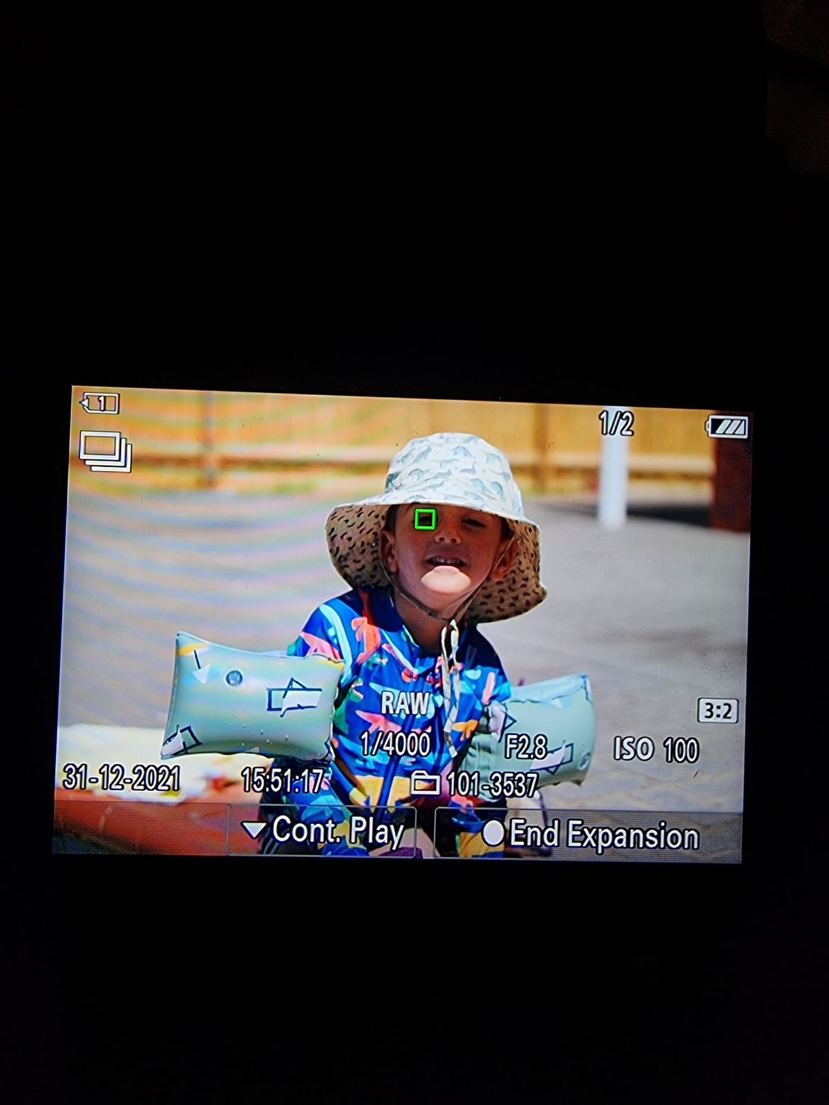

This image is not taken by me but I got it from a Facebook group where several people have issued this problem. In that image it shows that the focus should be on EYE but instead of that it is on the hat.

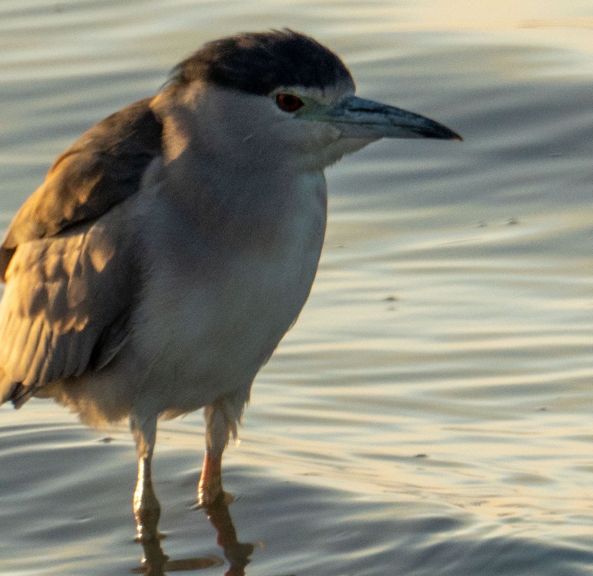

this one was with a7iv 200-600+1.4x at 840mm f13 s 1/1000.
