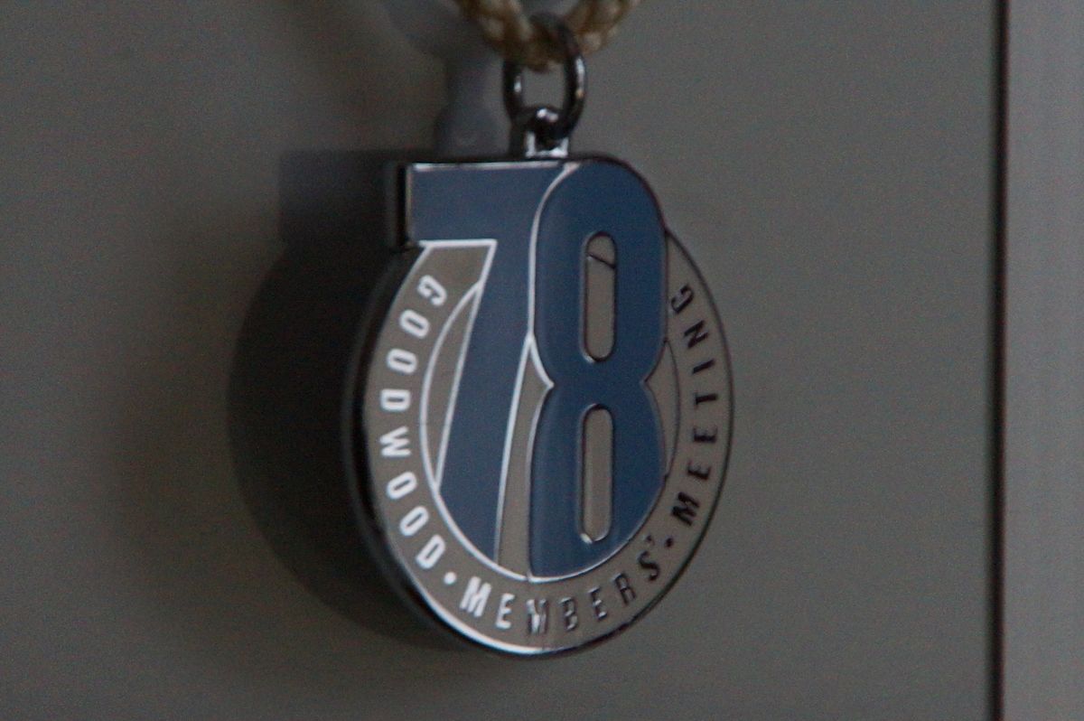

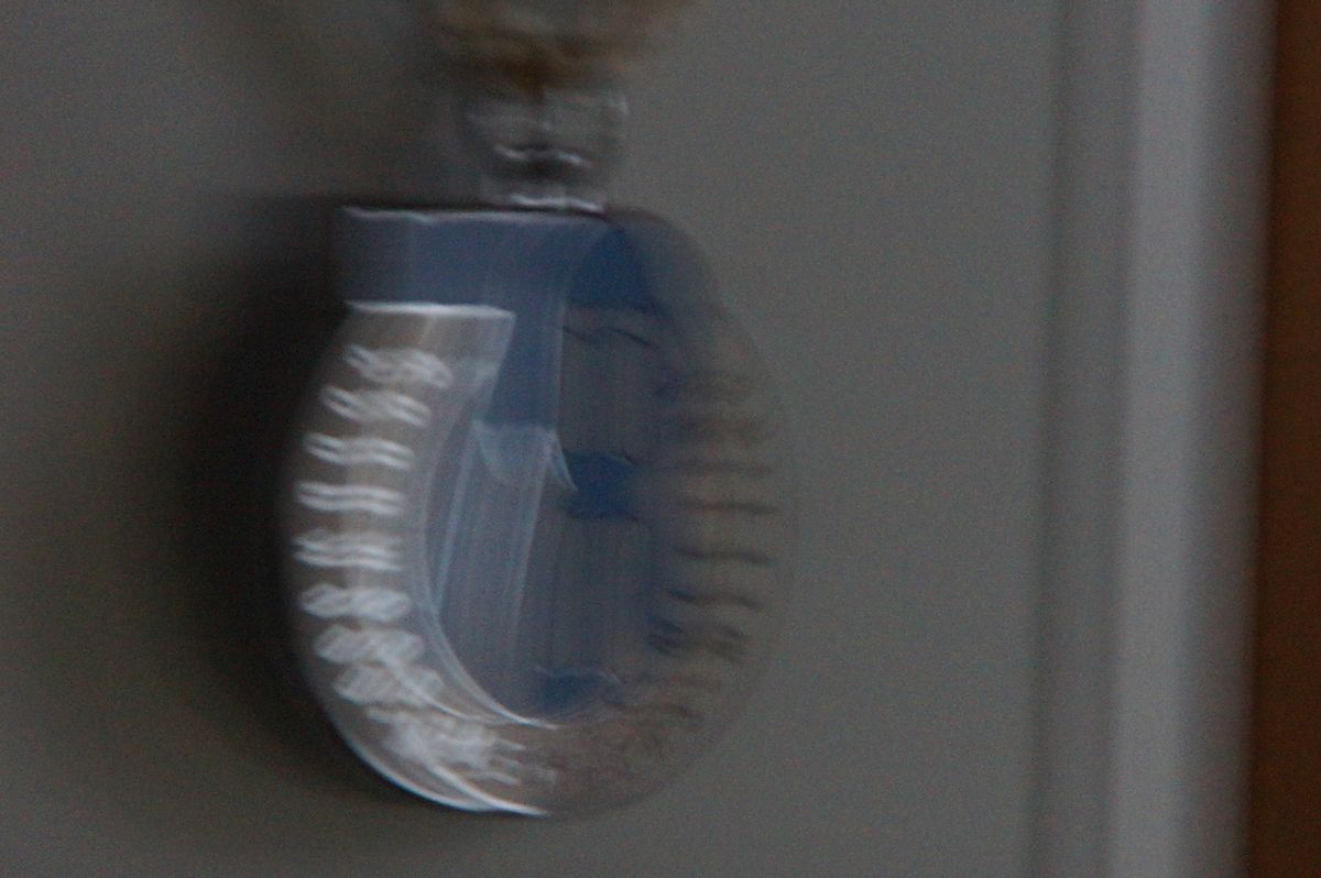

Blurred image is with steadyshot ON, same everything other than that.DSC04564.JPG
